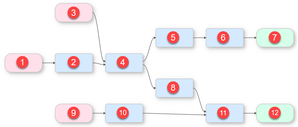

The algorithm for processing items in sequence is:
While there are items that need processing:
 Find the unprocessed Input item that is further left. If multiple Inputs have the same x position, choose the topmost one.
 Process the input
 Recursively process it's children, depth-first, starting with the top one in each branch. If multiple children have the same y position, choose the leftmost one.
For example:
Example processing sequence
