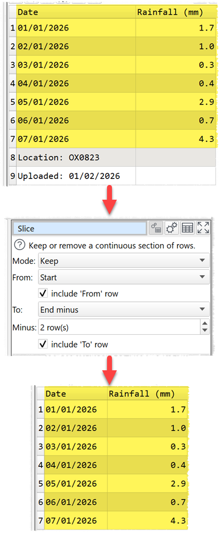

Remove the last 2 rows:
How to remove the last 2 (footer) rows from a dataset

oEnd for the last row.
oEnd minus for the last row minus an offset (set in Minus). E.g. Setting Minus to 5 means 5 rows before the last row.
